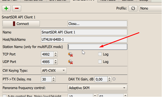

Greetings!
New SDC user here. I have a 6600/v3.8.23 trying to get SDC skimmer to work. I have followed the Flex setup guide on the lw-sdc.com website. The API connects fine over TCP/4992 but the UDP connection does not regardless of the port # I choose. The status icon does change from the red X to a broken double blue connector but never gets to the single connected blue icon. If I hover over the icon it reads 'Disconnect...'.
I am running on a Windows10 machine with no other apps running. SmartSDR is configured with 4 panadapter/slices with DAXIQ set to 1-4 respectively. The sample rate of the IQ channels are set to 48k which matches the rate selected in the SDC skimmer. When I start the skimmer the status changes to 'Wait Ready API...'.
Any help guidance will be greatly appreciated.
Tim/K1DC0 -
Try defining and opening a port, eg 4999, in the Windows Firewall.
Ensure you have Host / Nickname properly defined in SmartSDR API Client 1. For simplicity if you have a name for your radio, enter that.
DAX is irrelevant but you might try with just one Panadaptor / Slice to start though probably that is not the issue.
Finally, if all else fails, try a direct connection from Radio to Computer and see if there is a difference. If it works then and not before it is a router issue.

Yes but you have a router to provide internet. Try a direct ethernet link radio<>PC as an experiment to see if the UDP port 4999 opens.
One of Yuri's advices to help SDC users with this issue has been, and I quote: "Try plugging the transceiver directly into your computer's LAN socket and running SmartSDR and SDC ………….. If everything works, it means that your router is not allowing UDP packets into the SDC program."

Ok Tim, sorry, most users have their radio internet linked. So it is not that obviously.
There is a Windows command, run in a terminal window as administrator that will tell you the UDP ports in use and therefore not available to SDC. Logically, with SDC closed, if the port is not listed it should be available and open when requested in SDC. But who knows… post to the SDC Forum and ask the experts.
If I command netstat -an
UDP 0.0.0.0:4989 :
UDP 0.0.0.0:4991 :
UDP 0.0.0.0:4992 :
UDP 0.0.0.0:4993 :
UDP 0.0.0.0:4994 :
UDP 0.0.0.0:4995 :
UDP 0.0.0.0:4996 :
UDP 0.0.0.0:4997 :
UDP 0.0.0.0:4998 :which means that UDP ports 4989 and 4991-4998 are unavailable. I use port 4999 in SDC.
Yuri adds the following:
This often occurs when users incorrectly specify the station name for Multiflex mode here:
