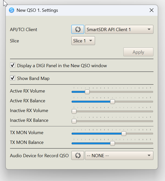

2 Audio levels are set with SDC. Open the New QSO settings (cog icon top right of window)

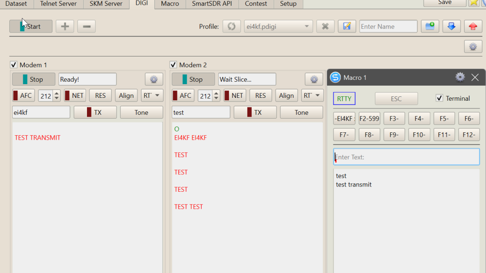

ALT+T hotkey in contest mode opens the terminal where you can either send interactively or from pre-defined macros. For interactive sending, just start typing and SDC will start transmitting (provided you have the "terminal" option ticked just above where you enter the text), it will go back to receive when all has been sent.
The "no tune in RTTY mode" is an annoying bug that still needs to be fixed on the Flex side. The radio doesn't send a tune signal whilst SDC has an IQ connection open. The only workarounds I have found is either to change mode (if the contest rules allow, otherwise you have to stop SDC Contest first), or stop SDC then you should get the tune carrier back again.
