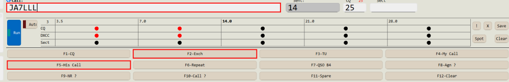

New SDC user here. I have a lot to learn. I like what I see so far.
When in run mode, what is the keystroke / mouse click process. I think I've figured out S&P, but I can't figure out a smooth way to run stations.
I've researched a bunch of youtube videos but I can't find one that specifically shows the how to run process.
For example, in N1MM: Hands on the keyboard. Enter the call, tab, hit the ; key which sends the exchange, enter the senders exchange then hit ' to send TU and cq. Hitting ' also logs the qso and clears all the entry fields and readies the entry window for the next qso.
How can this be done in SDC? I'm not looking to emulate N1MM, just trying to understand how its done in SDC.
Thanks
Rich - N5ZC
Keyboard: mouse in blank Call box will call CQ. Station appears, enter to send message (have this checked in Contest Options - Macros tab). Msg is your report, correspondent replies, I mouse to CQ box in case I need to amend recvd rpt and press enter which sends the TU msg and logs QSO. Much the same as N1MM.
If you have received two respondents, SDC has queued the second and will answer after the 1st QSO completes.
It is easier to do than to explain. Try and you should be good to go.
Thanks Erik,
The mistake I was making was hitting the space bar which moved the cursor over to the exchange field before hitting enter to send the exchange. If I leave the cursor in the call field, it works as expected. I also noticed that the highlighted macro's changed as I hit the space bar. That should have been my first clue to what was going on.
Now to play around in CQWW RTTY to continue my SDC education.
Rich - N5ZC
I'm impressed with SDC, nicely done program.
A couple questions:
- Is there a contest profile for November SS?
- Is there a quick key or combination of keys to clear the call entry field. I played with the hot keys but didn't have any luck, at this point anyways.
Rich - N5ZC
In run mode, clear the call box with 'Clear' or F12
In SP mode, it clears anyway though you can still press 'Clear'.
I do not see 'November SS' in the list but it might already be catered for. I would email Yuri UT4LW for advice. If it is omitted, he will add it for you.
Erik.
Hi Rich,
The backtick (`) key will clear the input fields. On the Contest → HotKeys tab you can see all the key shortcuts, if you tick the Show column that shortcut will be listed in a window when you start the contest (provided you have ticked "Show Hotkeys" on the main contest tab). I found having that visible with the basic keys I needed helped me when learning to use SDC.
Jonathan G4IVV
Erik, I'll email Yuri.
Jonathan, thank you for the tip. I'll play with the hot keys some more and look at the tick key.
Thank you .
Rich - N5ZC
Johathan,
It would have helped if I hit the correct backtick key. I was trying to use the single quote key, 2 keys to the right of the L key. Hitting the correct key helps, hi hi.
RIch - N5ZC
Ha yes that would help Rich! On my keyboard the backtick is on the edge and so easy to find in the heat of a contest.
I hope you enjoy using SDC, Yuri has done a fantastic job with this and it very rapidly became my contest software of choice (and to be honest the existance of SDC was a big influence in me switching to Flex).
Best 73,
Jonathan G4IVV0
