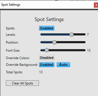

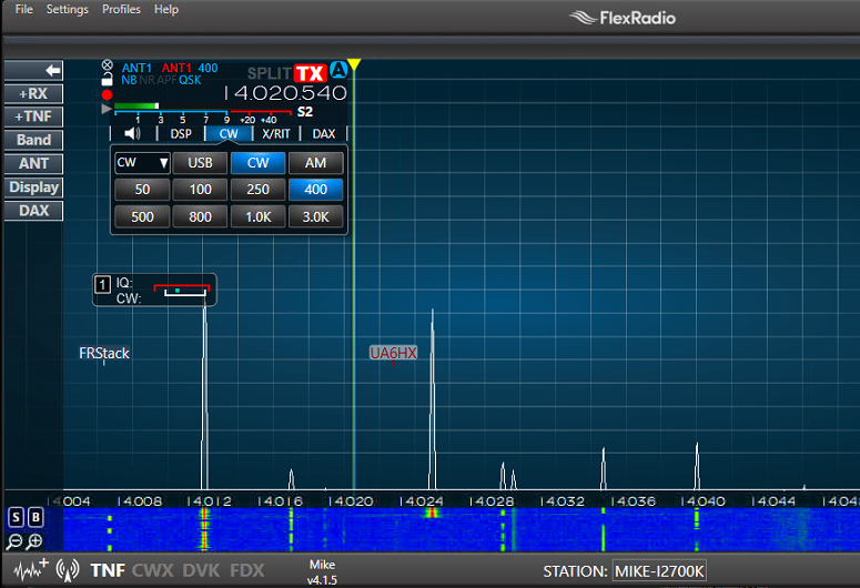

    I am trying SDC and having one issue with the spots. They don't seem to stay on the waterfall for more than a few seconds then disapear. The "Decoded callsign" box shows plenty, How do I increase the display time of the spots?
  • Erik Carling EI4KF
    This should set the lifetime though I have to say, quickly disappearing Spots are not normal and not the default. There may be something else at play. I presume Spots are enabled in SSDR. Please check and advise. Meanwhile someone else might know more so look out for further replies.
  • M0MDS
    M0MDS Member ✭✭
    edited 1:12PM
    Hi, this is how mine is dislayed.
  • M0MDS
    M0MDS Member ✭✭
    edited 1:14PM
    Ok, you are on an old version and I cannot remember why, when you have lifetime at 15 minutes, that you should have this issue. Someone else may chime in here. Or else, post your question to https://groups.google.com/g/sdc-ut4lw?pli=1
