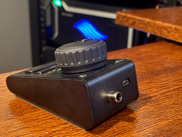

The other thing is that it is very easy to add an RCA jack to the back side of the RC-28 and solder in 2 wires and you suddenly have a port for a foot switch without the need for an additional dongle.2 -

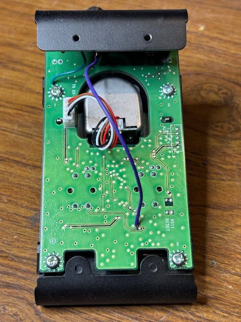

@K9YK do you have more instructions on the PTT modification?

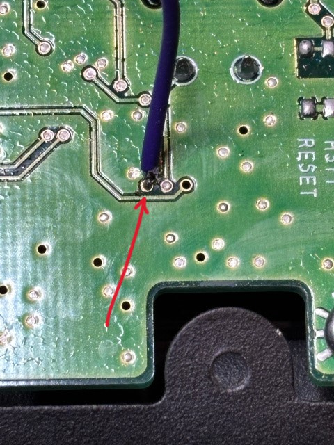

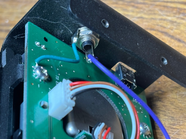

@Mike-VA3MW It's very simple, we are just putting the footswitch in parallel with the transmit button on the RC-28.
1. Remove the 4 screws that hold the back on the RC-28
2. Drill a hole in the back of the RC-28 and mount an RCA connector. Be very careful not to hit the PCB board inside the RC-28, and then **** out any little metal shavings that may have ended up inside. You may also want to put a piece of tape over the back side of the encoder (it has an opening) to prevent any metal shavings from getting inside. You can even unplug the encoder and remove the internal PCB if you want.3. Now you need to add two wires. The green wire is going to ground (one of the solder pads near the PCB mounting **** works just fine). The blue wire connects to the transmit button contact. You'll want to use a fine tip soldering iron and some very small gauge wire.
4. Connect the green wire to the shield of the RCA connector and the blue wire to the center pin.
5. Put the back cover back on and you are good to go.
