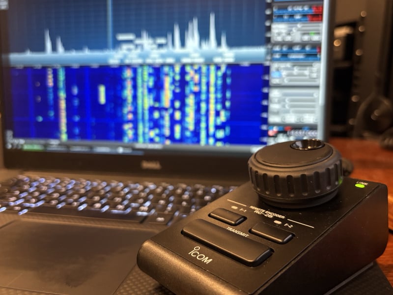

If you have an Icom RC-28 controller and would like to use it to control tuning in SmartSDR for Windows, you can now do so with frTune-28.

@Mike-VA3MW No, frTune-28 does not provide more functionality for the RC-28 than the native Flex Control does. For frTune-28, my focus was to provide tuning control, not a multi-function controller knob, so I did not make the F1/F2 buttons assignable. F1 changes the tuning step and F2 switches between normal tuning and RIT. Transmit of course transmits. I particularly love the snap-tune feature that I added to the software. It makes a click with the mouse in the panadapter always tune to the nearest 1KHz regardless of what the tuning step is set to.

@K9YK do you have more instructions on the PTT modification?
@Mike-VA3MW It's very simple, we are just putting the footswitch in parallel with the transmit button on the RC-28.
1. Remove the 4 screws that hold the back on the RC-28
2. Drill a hole in the back of the RC-28 and mount an RCA connector. Be very careful not to hit the PCB board inside the RC-28, and then **** out any little metal shavings that may have ended up inside. You may also want to put a piece of tape over the back side of the encoder (it has an opening) to prevent any metal shavings from getting inside. You can even unplug the encoder and remove the internal PCB if you want.3. Now you need to add two wires. The green wire is going to ground (one of the solder pads near the PCB mounting **** works just fine). The blue wire connects to the transmit button contact. You'll want to use a fine tip soldering iron and some very small gauge wire.
4. Connect the green wire to the shield of the RCA connector and the blue wire to the center pin.
5. Put the back cover back on and you are good to go.
