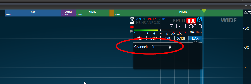

Mike-VA3MW Administrator, FlexRadio Employee, Community Manager, Super Elmer, Moderator adminOptionsIt doesn't look like you have the receiver slice assigned to a DAX port.
Check this:
Also, in the AUDIO settings TAB inside WSJT-X, ensure that you have DAX RX 1 for receive and DAX TX for transmit.

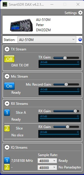

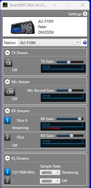

I've now installed everything on the AU-510M using version 4.2.18. Unfortunately, the DAX application isn't working properly. The RX streams aren't working. If I switch back to 4.1.5, everything works as usual. What can I do about this? Also, the Slicemaster doesn't work with 4.2.18 either. I hope this can be fixed?

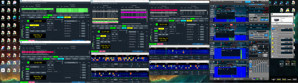

I done the update this morning and have restarted my computer 3 times wsjt-x is working but DAX does not state that each slice is streaming or show that there is any RX coming from the radio???
Figured out my problem it was just a hang up with ssdr or DAX what I did
with ssdr running 4 slices and wsjt-x closed down I closed out all the slices then brought them back up 1 by 1 and when I did this DAX showed each slice ready then I started wsjt-x up slice A thru D and DAX went to streaming showing RX gain to each slice so it was ssdr or DAx with a hang up not sure but this got everything going like it should.
