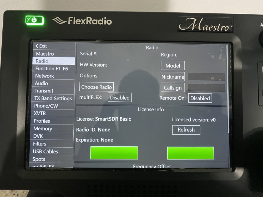

good evening sorry for the late response however they not communication between the Maestro and the Aurora. when i go in the menu in the Maestro and select Radio they no info on the Aurora, no Serial#: no Region no license info.

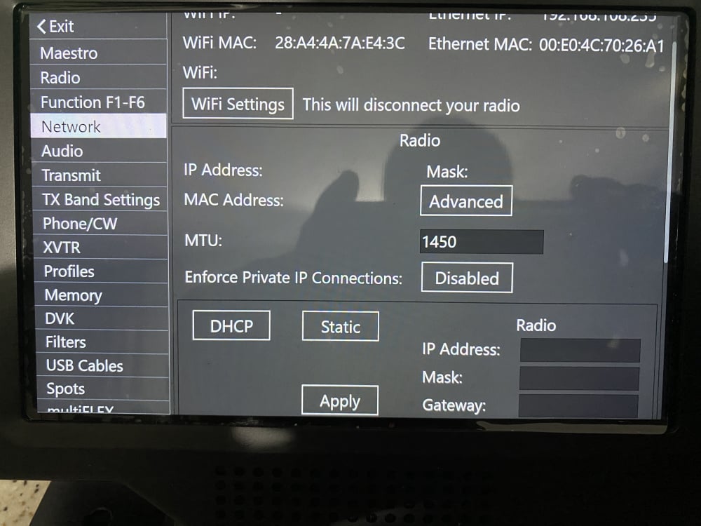

in Network the Maestro have an IP address, the radio have nothing no ip address no mast no MAC address

AUDIO, TRANSMIT,TX BAND SETTINGS AND ALL THE OTHERS ARE EMPTY PROFILE EMPTY0 -

Yes i am trying to connect to the Aurora via the network, and direct from the Maestro to the Aurora, Maestro have no info on the Aurora, no network settings. no Region, no Serial#, nothing and that is from the Maestro connected directly to the Aurora0

Ok everything you said I have done and the radio was working. I went into menu then network setting and in the advanced settings inter a static IP address ,subnet mast, gateway in the internet section . That’s when everything went down hill
OK… that's a step forward. If you remove/delete the IP info and let the network assign and address for each of the radio and Maestro, I think we can get it working again.
Unless there's some special networking requirement at your location, it's best to just let the network do the device addressing for you.

No communication between the Maestro and the Aurora at all.Is there a factory reset, or a reboot to original state.
the Maestro have an IP address, but seeing any for the Aurora. It doesn’t even have a Serial #
It’s like the Aurora doesn’t exist
