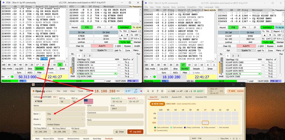

Couple questions: Where is the settings for a dark mode?

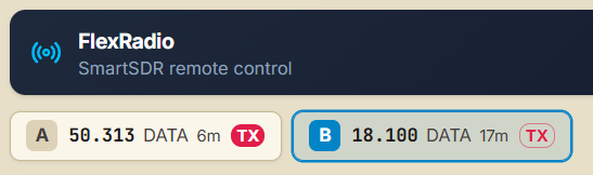

Under FlexRadio i can see 2 panadapters open
I have 2 JTDX opened and when click on the callsign on this example 50 or 18Mhz, callsign going to a "Callsign" field , but Frequency on the top stays on 18Mhz.
What do I miss?
Thanks
Mike-VA3MW Administrator, FlexRadio Employee, Community Manager, Super Elmer, Moderator adminOptionsEdit, Preferences, General
