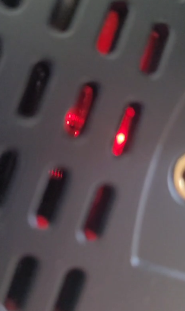

Has anyone encountered this issue? I have to take the battery out every time I am done using it or the battery will flatline within a day or two.

    That is exactly what happens. Full charge and unplug charger. Even with battery removed and reinstalled. It isthe same thing.

    I bought the original with the unit from WIMO. The Red led stays on inside the unit. https://www.youtube.com/shorts/y5WiYlLP1cQ
