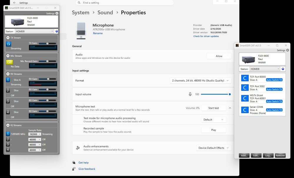

Right now the mic keys the radio PTT if I set VOX. but no audio transmits. Also no audio TX if I click MOX on SSB. DAX streams show up as active.

If I hit MOX it keys the radio but no audio or power out. If I choose VOX the mic keys the radio and I see a tall column on the signal screen, but to audio or power out.

Take a look at this. Its probably the DAX mic stream off? but it doesnt just turn ON when I hit that yellow button. Clicking that and it goes gray or yellow, never blue
Mike-VA3MW Administrator, FlexRadio Employee, Community Manager, Super Elmer, Moderator adminOptionsThere can be many things:
- Check mode
- DAX is not required, so you can terminate it up
- Make sure TX DAX is not on
- Reboot the radio and test again.
Mode was USB so thats fine. I thought DAX is the audio interface or manager between the PC and the radio. I dont know what terminate up means. Is there a YT video you know of that touches on this?
The TX DAX turns off in the slice flag? or where?
Mike-VA3MW Administrator, FlexRadio Employee, Community Manager, Super Elmer, Moderator adminOptionsFor Voice, DAX is not required. That is only for digital modes and using it to send audio from things like N1MM Voice Keyer.
