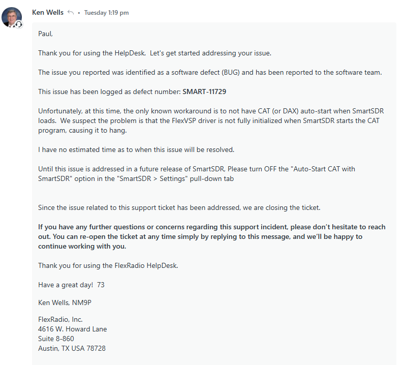

I'll paste the reply here
Hi Ken
Thanks for that reply.
I just wonder where that was sent to , Definitively not to me direct….
So I'll just wait for the fix…
Paul F6EXV
It went to the email address you opened the ticket under. Your hotmail address. The email was sent.
Hi Mike
Well, I did not receiove it, but what matters is that I have the answer !
Thanks again
73 + TU
