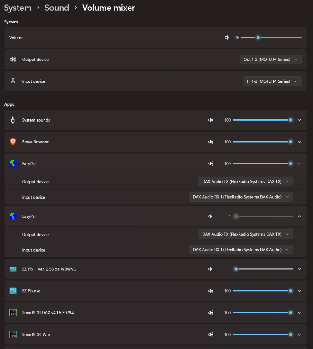

If you can not see Flex TX and RX option in EasyPal.
If you open EasyPal, then open Windows "Sound Mixer Options" and scroll down to Apps list. Select the drop-down to the right of EasyPal, select the correct TX and RX devices, they will be set to default. You may see another entry once you start the process in the Mixer for EasyPal, just set it as well. Now close and reopen EasyPal, and you will see the option you want at the top of the list.
