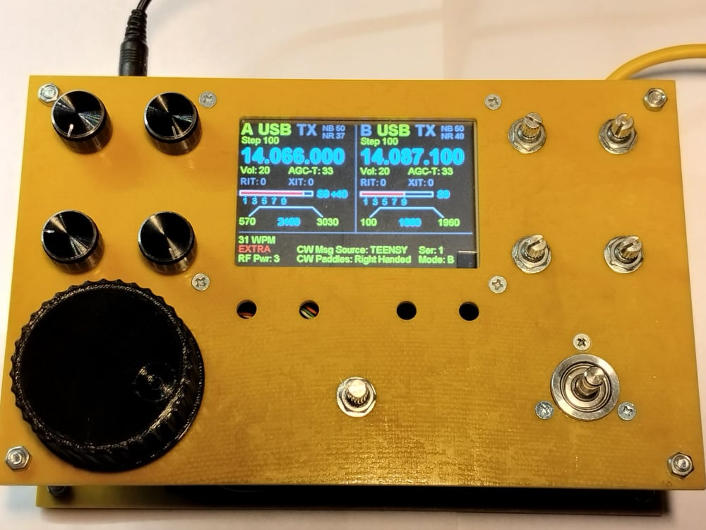

I want to take a moment to express my gratitude once again to everyone involved in this project. It has given me so much, not only the joy of building the hardware itself, but also the opportunity to expand and customize the software with features of my own. That ability to add functionality is truly inspiring and opens up endless possibilities. For me, it has become a really enjoyable side project and hobby alongside amateur radio.
I would also like to share a picture of my setup. In my case, I’ve made use of the often unused area for slice B to display a small clock widget. It shows the time in any time zone, synchronizes with an NTP server, and provides some additional useful information.
Many thanks again to Len, KD0RC, Simon, NV0E, and everyone else who has contributed their time and effort. Your hard work and dedication are very much appreciated.

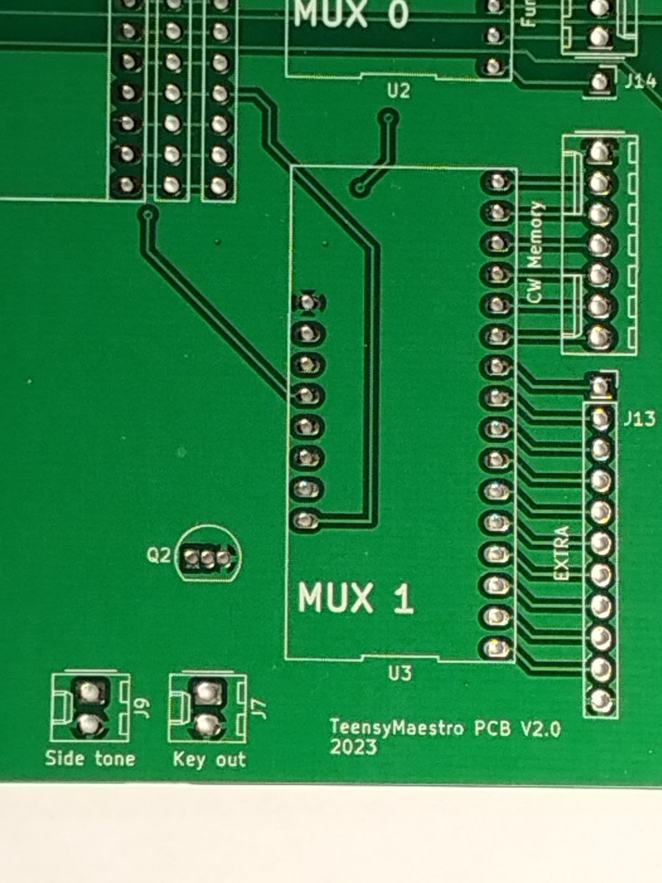

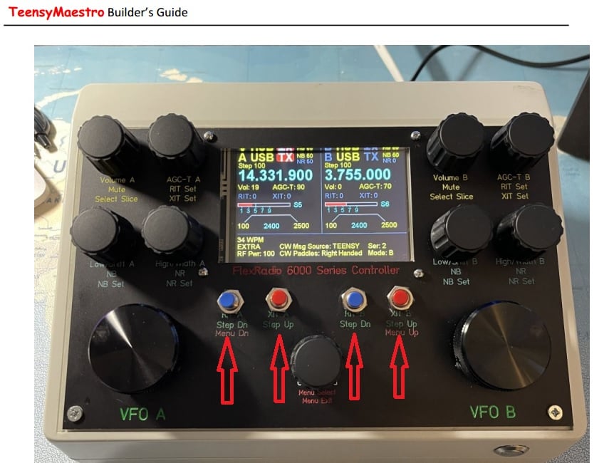

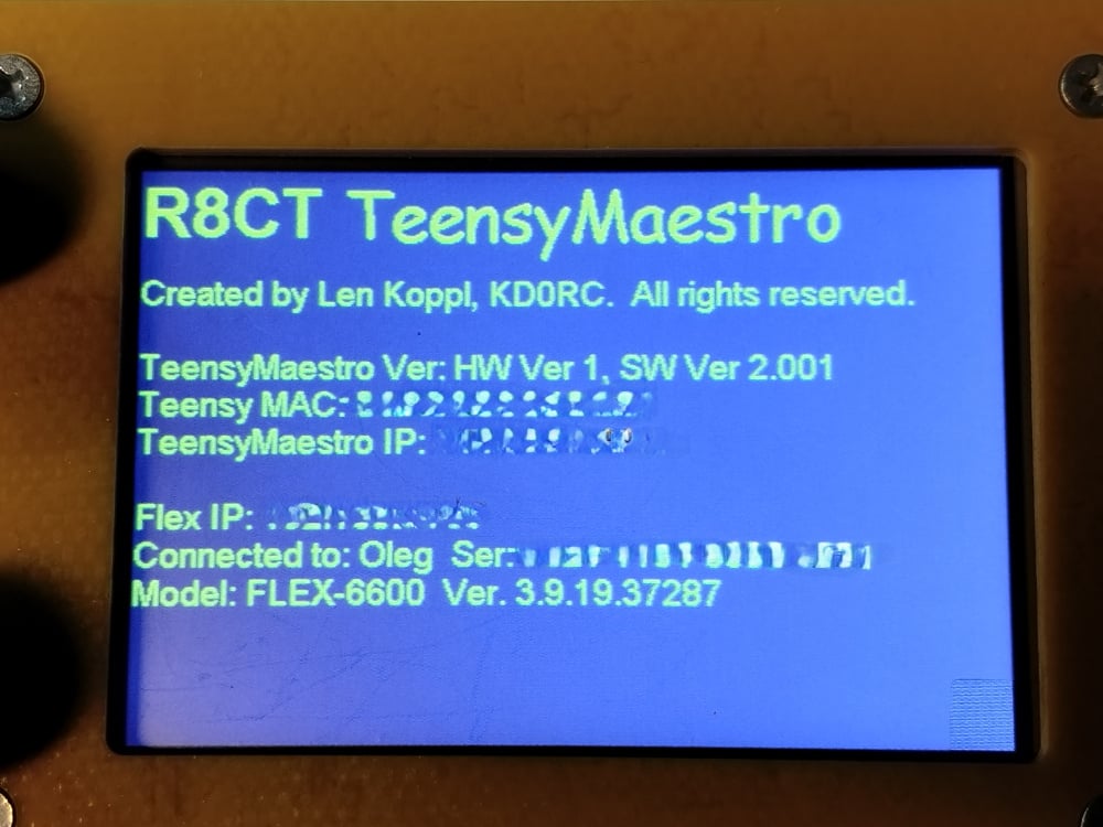

Greetings.
At this moment i had compile TeensyMaestro in temporary box.
Len, i wonder about buttons marked red arrows - were this buttons connected on PCB ?
Does it J1 connector?
I am in use this circuit diagramThank you.
regards, Oleg
Hi Oleg, It looks like you are using hardware version 1, so you need to use the V1 schematic:
They would connect to pins 9, 10, 11 and 12 of MUX 0.
Congratulations on a very nice looking TeensyMaestro!
Len, thank you.
I have this version of PCB - does HW version is v.2 ?
I had compare schematic diagram V2 and PCB V2.0 and found that they are equal.
May be i need to substitute SW to version 2.0 ?
Regards,
Oleg
