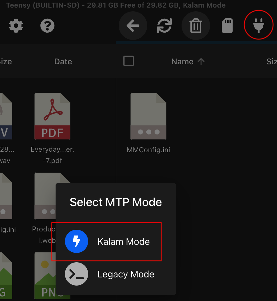

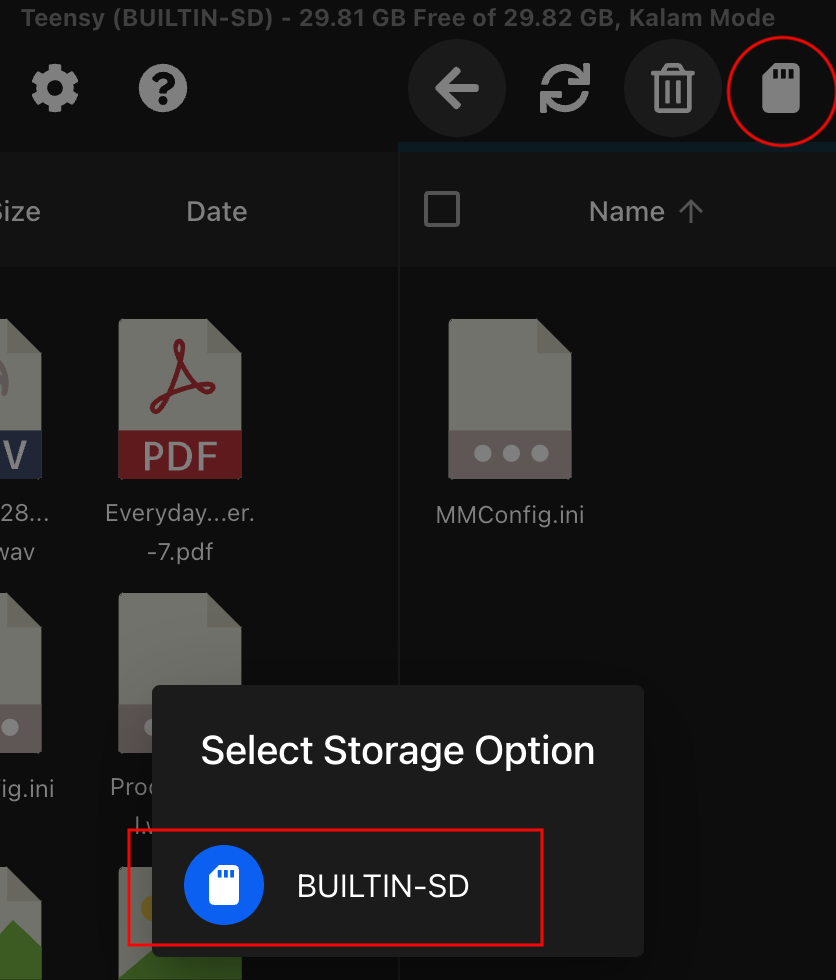

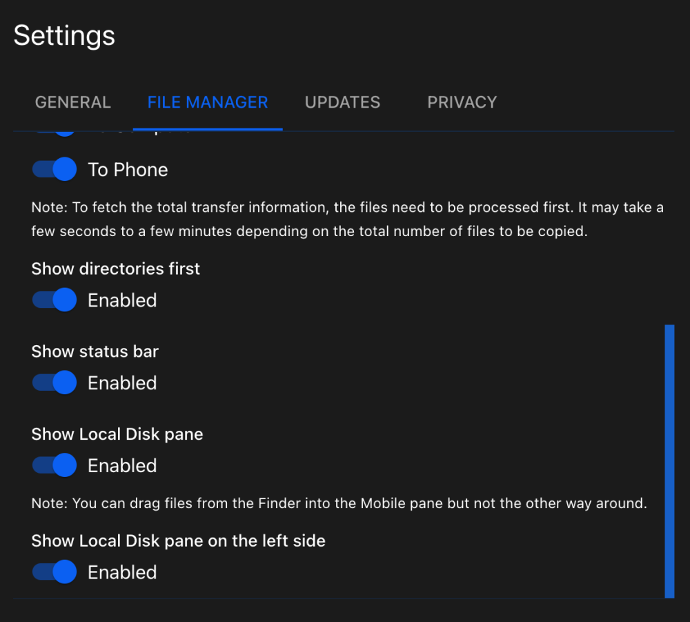

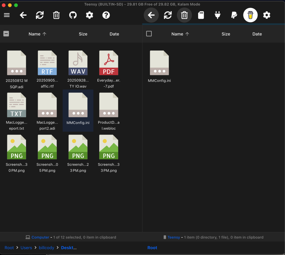

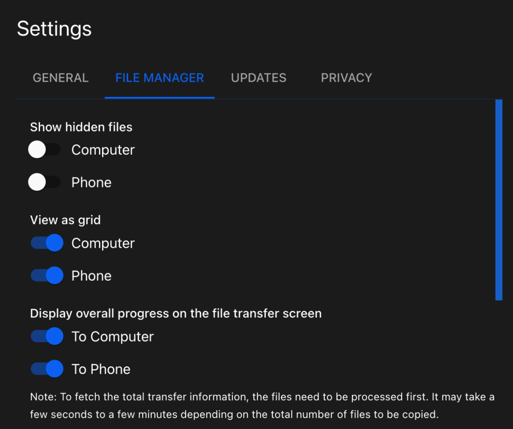

I don't recall anything special except having to hit the refresh icon. I've attached screenshots of perhaps pertinent configuration settings.
Hope this helps!
To modify the Teensy file, all I needed to do was drag it to the left pane, make my changes, and drag it back to the right pane.
