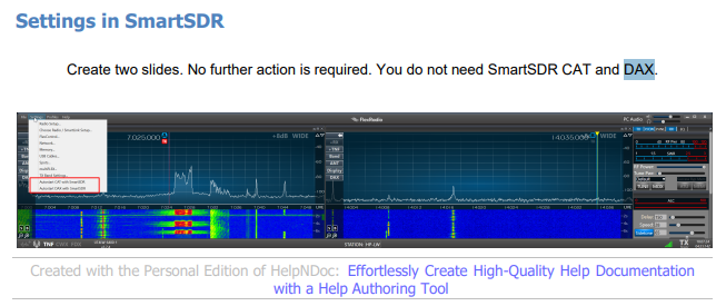

Hi Mike,
SDC does not use DAX, it talks directly to the Flex TCP and UDP API endpoints.
Jonathan
You learn something every day. Thanks for sharing. I must have missed the fine print on that. :)
Hi Michael
In version 3.10.10 there was a change in the UDP-IQ stream that was incompatible with SDC. I had a conversation with the developers and they informed me that there will be an update of the transceiver program.
I can make changes to SDC to be compatible with these changes, but there are other issues that have occurred in the new version that need to be addressed. Therefore, I cannot recommend 3.10.10 to work with SDC.
