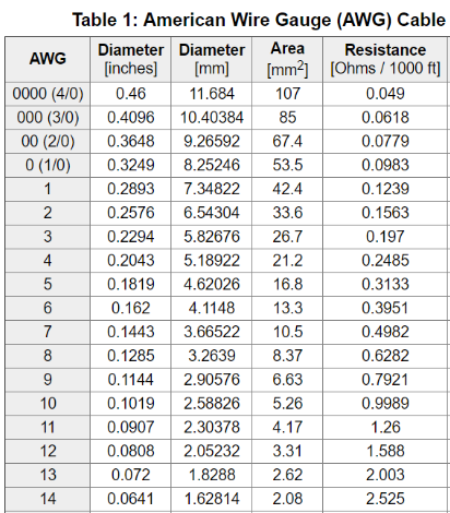

Based on my limited understanding, voltage will drop under load, but how much is acceptable? Is it possible to have minimal drop with a longer thicker cable?
The voltage drop is more or less the same whether I use the Astron or Alinco.What is the math formula to calculate the drop over distance and gauge?

W4RXK…OK well you have shown the majority of the voltage drop is due to the resistance of the wire. (You can see the internal voltage using FRStack. Install it if you have not already.)
As I mentioned previously, just use Ohms law, E=IR. To determine the voltage drop, multiply the current through the wire by the resistance. You can determine the resistance of the wire using an AWG Table:
Remember that each wire (2-conductor) is part of the circuit so to determine the resistance of the wire you have to include both. So if your cable is 4' long calculate the resistance for 8' of wire.
You can connect an ammeter in one of the power wires to measure current or if your power supply has one use that.
