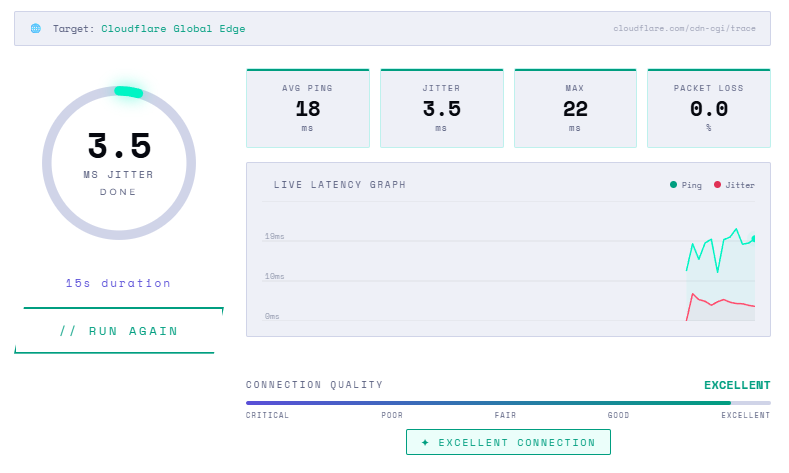

    You can test your Jitter and see what it looks like: https://jitter.is/
    This is what a stable terrestrial connection looks like. It will be interesting to see what you are seeing.

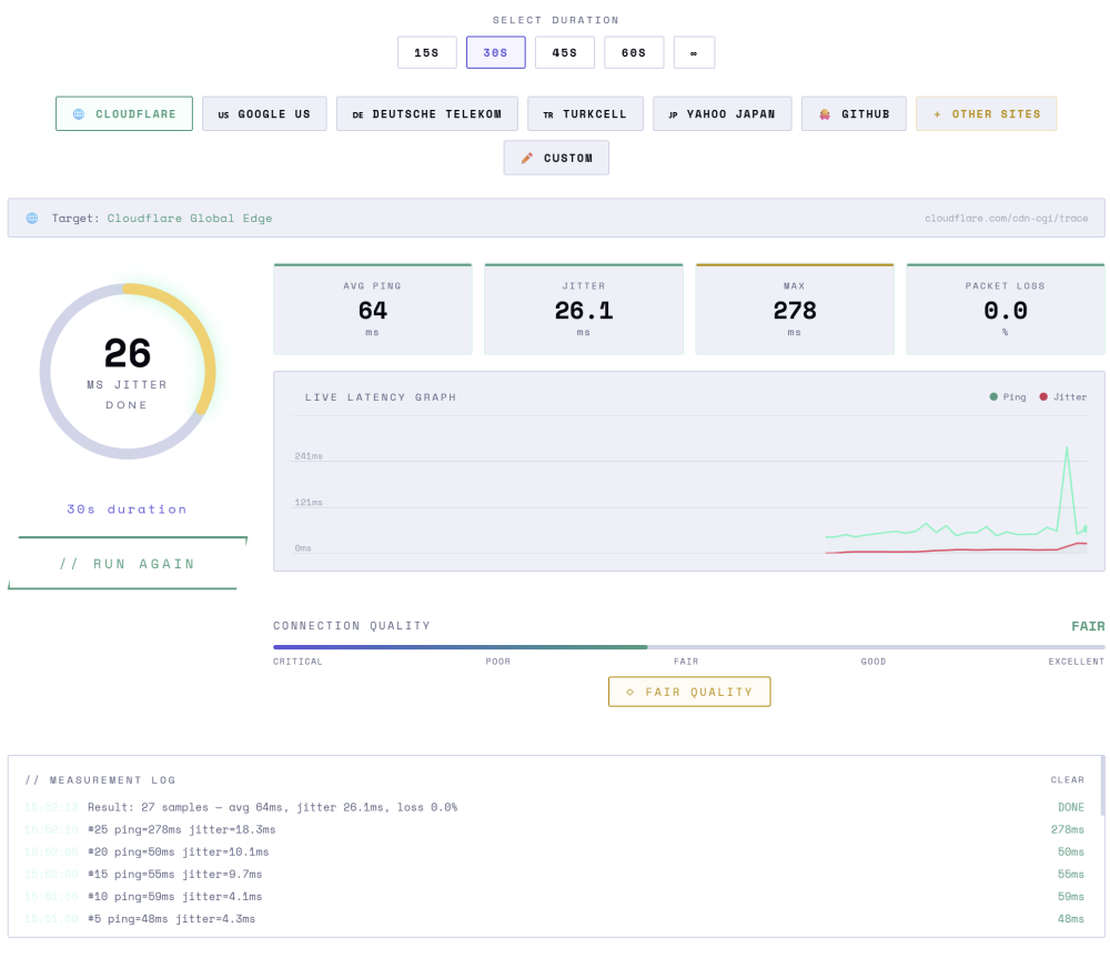

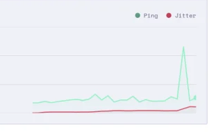

    super good to get your message. Ive tried so many things and finally your message says what is happening. I had no idea so now I know. Ive read about other hams doing well on Starlink so I thought I was good to go. So, some areas work and some dont? Or is it the long route from the Starlink to my WiFi that is making it worse? Here is an image of my jitter test now. Heading N at 20 knots to the Bahamas. (from USVI area)
    I suspect it is the DPI that is killing you and this is to be expected in something like a cruise ship or even a hotel. It is something controlled by the Shipline (or Hotel) as example.
    This 250ms delay is likely contributing and that happens that you got slowed down because bandwidth was allocated to another user or it was Starlink switching birds. Sadly, I am only guess and there really is no way to know.
    But, also make sure it isn't on the radio end. Dial down your FPS and RATE on your client to reduce the waterfall data and the panadapter data amount. Make it the minimum and you can do it on both iOS and Windows. This knocks down the upstream data from the radio just in case your router at the radio or your ISP is limiting you.

    Mike, you wrote Dial down your FPS and RATE on your client to reduce the waterfall data and the panadapter data amount.
    I wish I was still on that cruise to try that. Where are those settings located? You can see the jitter test I made is marginal with a much higher number than your 3.5 was. BTW, I was loosing audio as well, when the pan would freeze.
