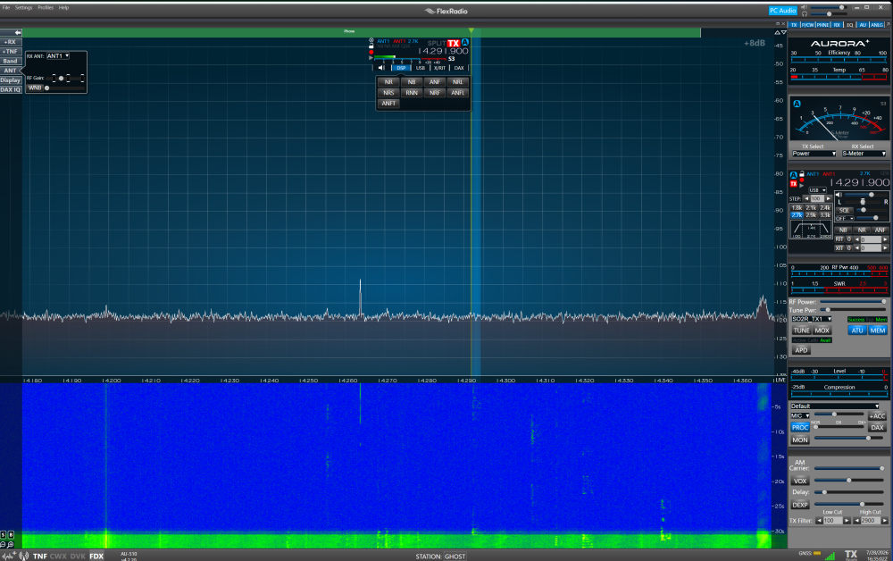

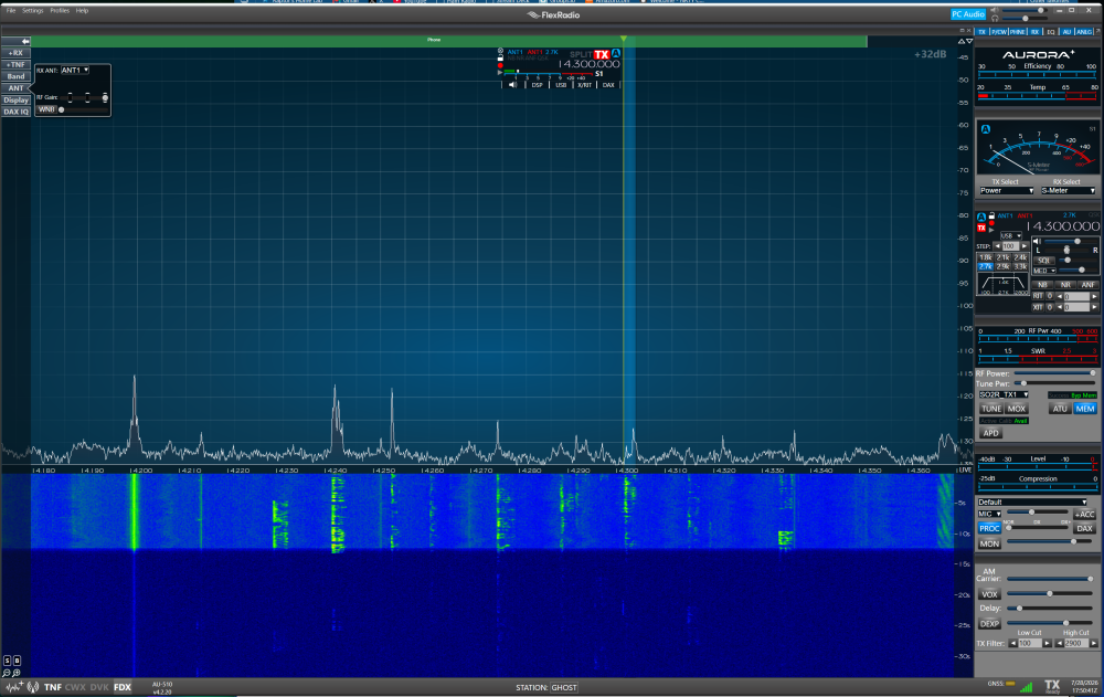

Here are two screenshots showing RF Gain set to 8dB and 32db. Adjusting the AGC-T slider does change the noise level but does nothing to improve audio signal. The antenna is a Chameleon Tactical Delta Loop connected with 100' LMR 400 directly to the radio. Not my normal antenna. Set it up as a test to compare to my usual antenna - a MyAntennas 66' EFHW. Normally this is connected through a wall mounted box with lightning arrestors. That arrangement behaves the same way — it requires full RF Gain on 20m to hear a good signal.
Mike-VA3MW Administrator, FlexRadio Employee, Community Manager, Super Elmer, Moderator adminOptionsthanks.. the picture really helps. What happens if you take the ATU and put it in bypass? I would also try ANT2. Even thought it is the same SCU, there might be a change.

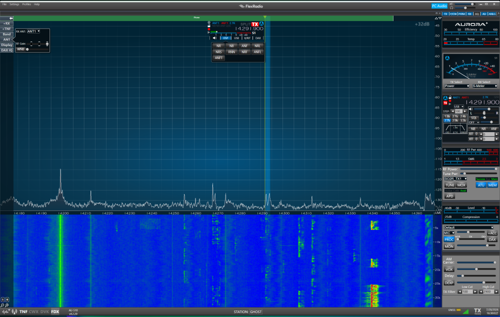

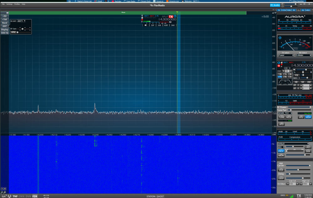

Hi Mike, thanks for the replies. Here are screenshots at 8dB and 32dB with ATU bypassed. Nothing changed. Also tried ANT2 and got the same results. I also see another comment has come in about setting AGC-T to Slow. Nothing I do with AGC-T changes anything other than adjusting noise. Bottom line is I have to run RF Gain at 32dB to see anything on the waterfall and to hear signals. When I drop it to 8, everything disappears on the waterfall and I cannot hear anyone.
