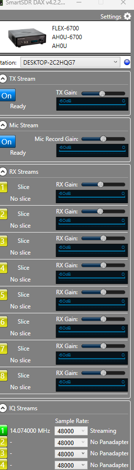

I have been using VER4.1.5 with mu 6700 and WSJT Improved and the new ver of SliceMaster ver. H I did a complete install of Ver. 4.2.2 …. cold started the 6700 and now CW Skimmer works but WSJT Improved does not…CAT seems to work as I can change bands but the is no audio..looking at the DAX screen it shows no audio and clicking on the buttons does nothing.
What did I moss??

    Tnx… seem to have it working but the DAX screen is locked out and I can not adjust anything and
    it only shows one stream when I have two running
  • David Decoons, wo2x
    We'd need a screenshot of each slice flag with DAX clicked in the flag to see what DAX channel (if any) are selected.
