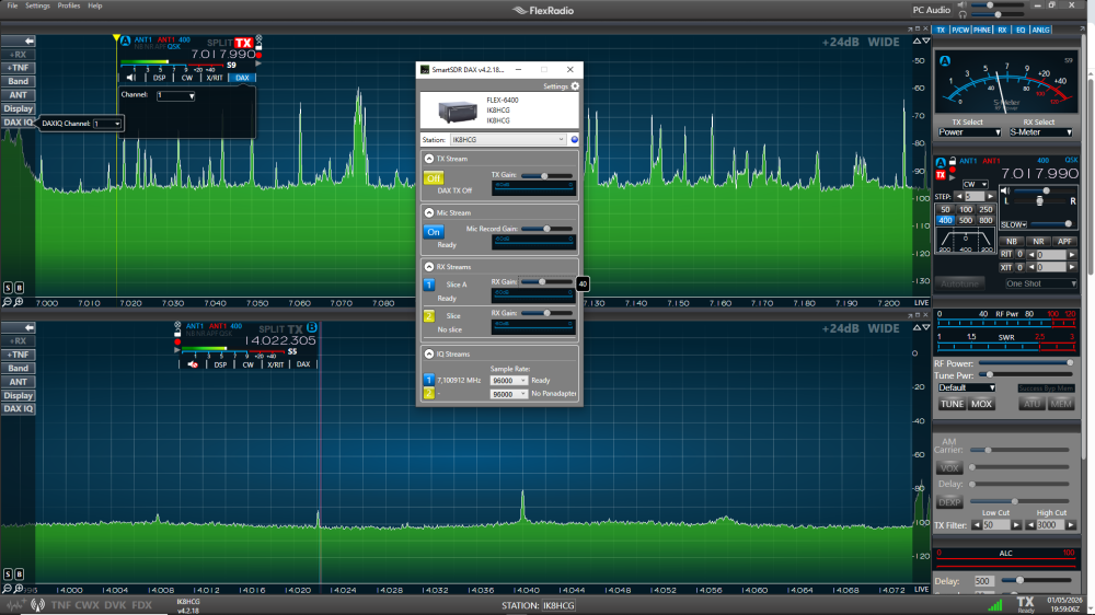

in DAX
basic v.4.2. There is no audio stream
1.png 494.3K
  • johnn1jm
    johnn1jm Member ✭✭✭
    You need to use it in a program like MMTTY. Then it will turn green and you will see level. This must be a change in the new DAX, Experts please comment.

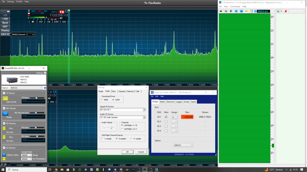

  • IK8HCG
    IK8HCG Member ✭✭
    There's no way with SDR Bridge. I spoke to Ed W2RF who will try to make some changes.
    2.png 372.9K
  • Mikel DL9ECA
    Mikel DL9ECA Member ✭
    Hi Guys, i had the same issue. i set up a new PC with win11. completly new. everything runs ok, only dax was not working. i found that if i put in my log program (UCX log) a receive channel in the soundcard tab, the channel maybe DAXRX1 was streaming. If i change to DAXIQ1, What makes no sense for the logprogram, the skimmer works, also the mtty machine runs. So for me it seem that the DAX is only streaming if a secondary program calls the channel from DAX. But that did not work with mtty and cw skimmer. Maybe that could be a hint. Mikel, DL9eca
  • IK8HCG
    IK8HCG Member ✭✭
    I downgraded to 4.1.5 and everything works again with sdrBridge and slicemaster, especially AetherSDR.
