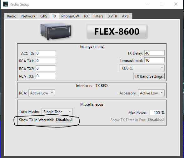

Since installing SmartSDR 4.2.18 I find that, when operating on satellites in full-duplex with transverters, the waterfalls in both panadapters (VHF and UHF) completely freeze when MOX/PTT is engaged on either band. This makes it impossible to see the downlink on the panadapter and to make uplink corrections for Doppler shift. Is this issue unique to me, or have others experienced the same issue when using full duplex mode?
Hi Mark, do you have Show TX in Waterfall enabled?
Thanks. That resolved the issue. Previous upgrades to SSDR have not changed that setting, but the installation of 4.2.18 apparently did.
