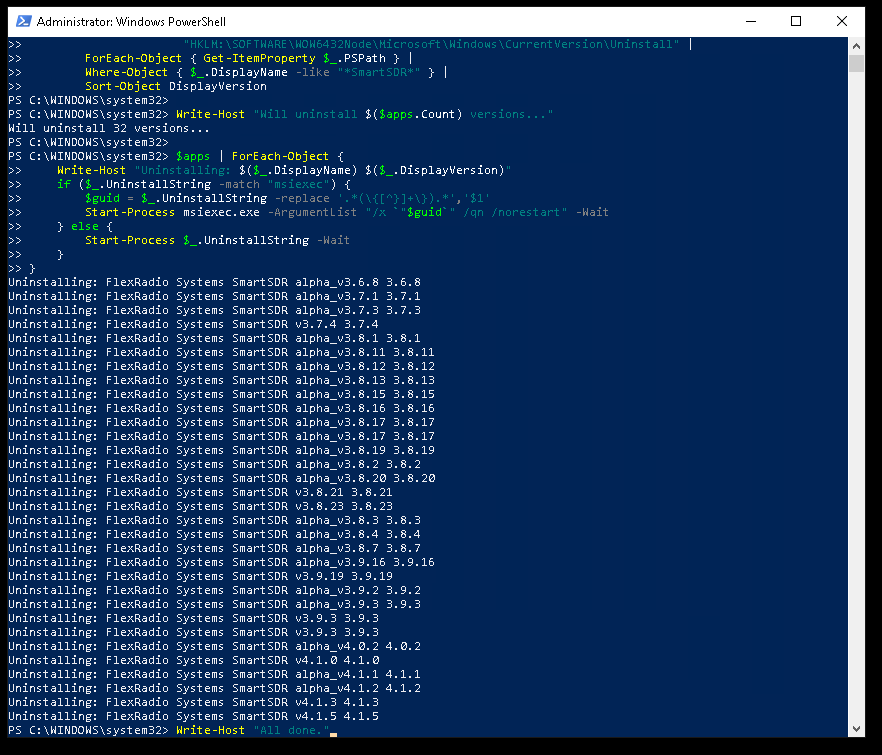

I (me, not FlexRadio) wrote this script to help remove all copies of SmartSDR which makes it a bit easier than doing it through Add or Remove programs. You still have to use your mouse, but it is a LOT faster. :)
As you can see, I had a few versions on my computer.
I had a bunch to remove.
It should not remove 4.2.18, but I haven't tested that part.
Run it as Admin under Windows Power Shell.
And, if doing this scares you, then you should not do it. :)
$apps = Get-ChildItem "HKLM:\SOFTWARE\Microsoft\Windows\CurrentVersion\Uninstall",
"HKLM:\SOFTWARE\WOW6432Node\Microsoft\Windows\CurrentVersion\Uninstall" |
ForEach-Object { Get-ItemProperty $_.PSPath } |
Where-Object { $_.DisplayName -like "*SmartSDR*" -and $_.DisplayVersion -ne "4.2.18" } |
Sort-Object DisplayVersion
Write-Host "Will uninstall $($apps.Count) versions..."
$apps | ForEach-Object {
Write-Host "Uninstalling: $($_.DisplayName) $($_.DisplayVersion)"
if ($_.UninstallString -match "msiexec") {
$guid = $_.UninstallString -replace '.*(\{[^}]+\}).*','$1'
Start-Process msiexec.exe -ArgumentList "/x `"$guid`" /qn /norestart" -Wait
} else {
Start-Process $_.UninstallString -Wait
Write-Host "All done."
