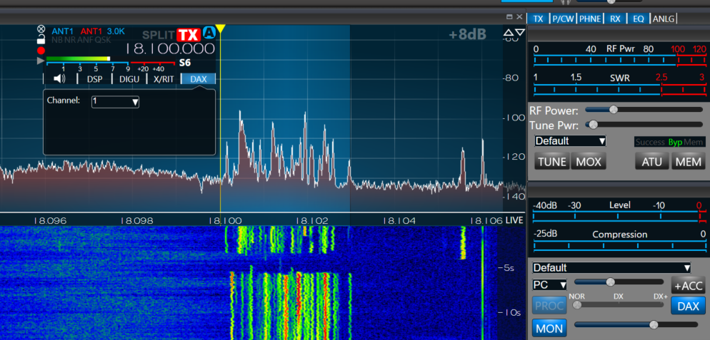

I just did the upgrade. No issues except Dax RX does not stream any data. I can transmit and see my signal being received on PSK Reporter.
I deleted all old version prior to loading 4.2.18.
I don't see any installed app for DAX or VSP.

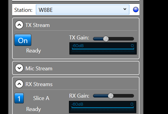

    No they are part of the SmartSDR app.
    Note the required changes needed to digital mode programs so that they work with DAXv2.
    Streaming on DAX RX will not be present if there is not any incoming data. Check your digital program, example WSJTx, that you have accurately changed the Input to DAX RX1. TX may work even if you have not made the required change per the Flex instructions but still make the change to DAX TX.
    https://helpdesk.flexradio.com/hc/en-us/articles/49224229297563-Configuring-WSJT-X-for-the-Aurora-and-FLEX-Series-Radios-using-DAXv2
  • Mick  W8BE
    Mick W8BE Member ✭✭✭
    I did not realize the icon now followed the connection state to the application. I had the input source set to IQ 1. All is well now..
