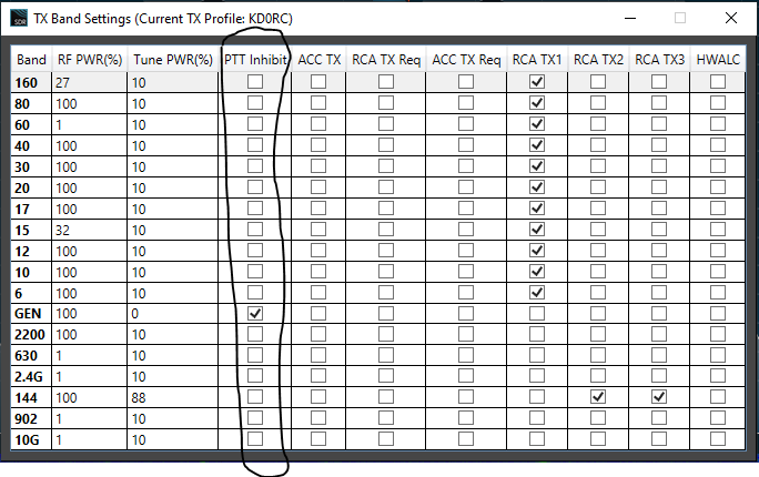

First, make sure that the PTT Inhibit is not checked for bands that you want to transmit on:

I also commented on your FB post. I see you narrowed this down, but if you are still stuck, don't hesitate to open a support ticket.
