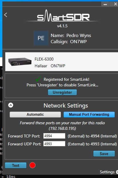

After my recent network change my smartlink wont connect any more remotely. On the local network all fine.
The funny thing is the 6300 shows up in the smartlink window with the ports I am forwarding in my router. Same ports as in the past nothing changed. The test button stays red in both cases (I tried both UPNP and manual). Whatever port I assign and forward shows up while hovering over the remote client (that has multiple radios) but once I connect the smartlink screen disappears and I get multiple popups : "unable to connect to the radio, please try again" and after clicking them away the missing radio shows up again on the remote PC screen.

Tried uPNP but it does not work. Asus AC86 router. Tried also forwarding via ports 21000 22000 no difference. Tried TCP/UDP, now on both, no difference.
The funny thing is that the remote PC displays the right ports when hovering over it (cannot maker screenshot), and also shows multiflex when somebody is using it locally, but crashes completely when I try to select the radio…

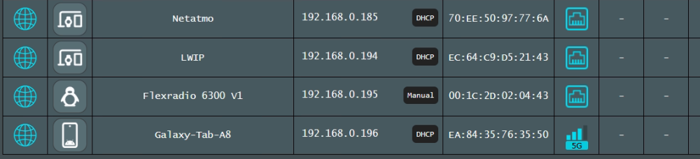

see below "radio internet NOT available" what does this mean ????? I can ping the radio from the network. I see the radio on the router. tried both DHCP or fixed IP no difference…
Totally puzzled…
Serial: 2114-4043-6300-3279, Max Licensed Version: v4, Radio ID: 00-1C-2D-02-04-43, Radio IP: 84.196.245.231, Radio Internet: NOT Available, Radio Firmware: v4.1.5.39794

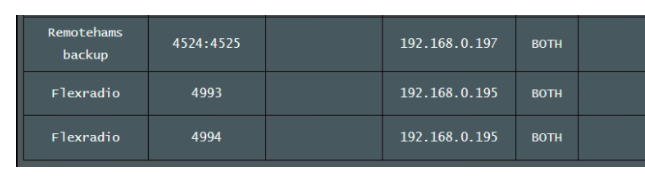

port forwarding table:

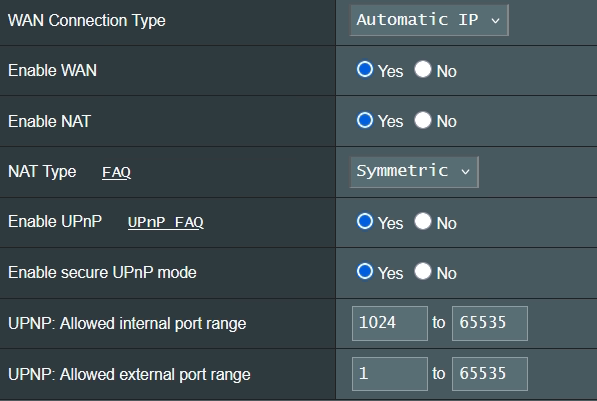

uPNP settings:
Mike-VA3MW Administrator, FlexRadio Employee, Community Manager, Super Elmer, Moderator adminOptionsThis is not going to work and while it looks like BOTH should work, it doesn't. You need one for TCP and one for UDP.
Since you have UPnP turned on in your router, delete all the manual port forwards in your Router.
On the Radios SmartSDR use Automatic settings. It will do all the hard work for you and do it correctly. Reboot router and the radios.
Reboot the Router and the Radios and then check your UPnP tables.

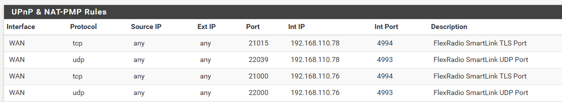

The Source Port can be anything assigned by the radio. When do, your port forwards look like this. You can see that the source ports are all unique, and they need to be. The INT ports are unique, but only for each radio.
This is my pfSense table for my 2 radios.
BOTH does work, it was previously on TCP and UDP and it did not work either.
Of course I deleted the manual entries before going to uPNP but it did not work.
