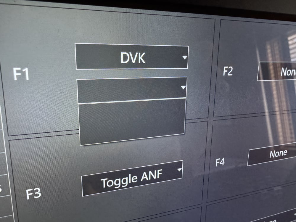

DVK works great on Maestro but can’t save recordings to Function Keys
On my Maestro C I can chose DVK for the Functions buttons but when the second dropdown menu appears, there are no dropdowns to pick which DVK to tag to that Function key. Is this aspect of DVK not activated yet in V4.01? I am a paid Flex SmartSDR+ Early Access subscriber.

EA subscriber in UK has this on his 8600M but same as you on his separate Maestro ie no function key tags.
I have cold rebooted the radio and still no joy. DVK works but I can’t assign the recordings to F keys on the Maestro as they won’t show up in the second dropdown menu.

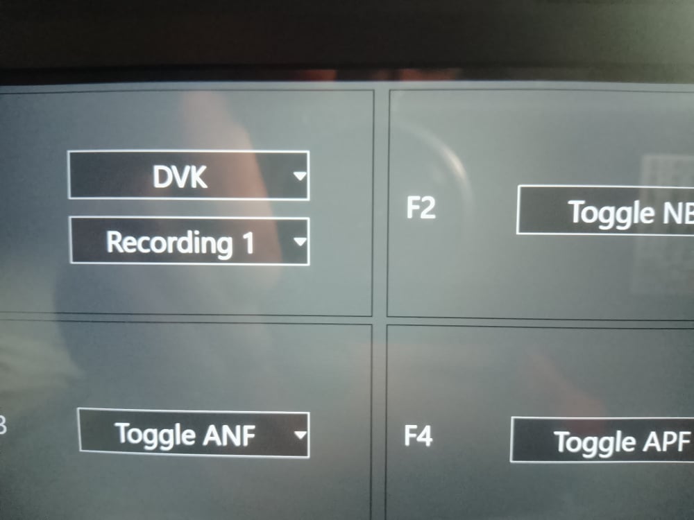

On my 8400M, I can assign DVK recordings to the F keys but on the next boot they have disappeared. They are still in SSDR (4.1.3) and working from there and so I have a radio issue. I have tried a factory reset.
I've opened a ticket on 4.2.20. I'm also running SmartSDR+ on my Maestro-C and can't assign any DVK Playback recordings to Function F1-F6 keys . The drop down box is empty.
Flexradio Helpdesk provided this response:
- Defect Tracking Number: SMART-12805 Maestro Does Not Display the DVK Recordings in Function Key Menu over SmartLink
- Current Status: Under Engineering Investigation
- Workaround: Unfortunately, there are no known workarounds available at this time.
