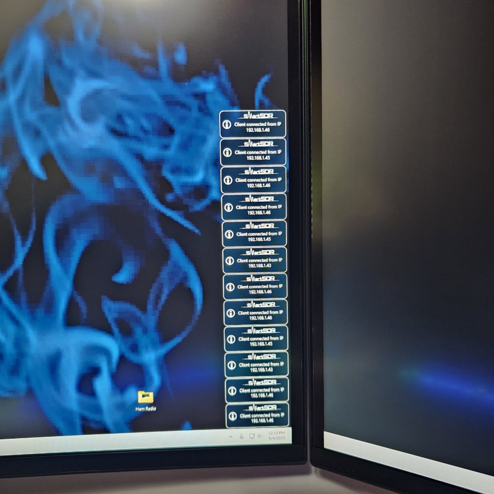

I am getting numerous errors when I try and run 8 slices on my 6700 that never had these issues. I'm running a i9 64gb computer that previously had no trouble running 8 slices.
This is occurring with 3.10.10 and the previous 2 versions. The flex runs thru a 8 connection switch that has just been replaced thinking it was the problem.
Running only 4 slices all is normal is it something in these latest updates that no longer lets the 6700 run all 8 slices with a fast bootup?

It looks like the devices at 1.43, 1.46 and 1.45 are repeatedly connecting to the radio. Do you know which devices those are?
They are the 403 Tuner 403 Antenna Genius and the PGXL.
If you run 4 slices it all works great as it always has just not with 8 Slices.

This sounds like something that you should bring to 4O3A's attention.
Mike-VA3MW Administrator, FlexRadio Employee, Community Manager, Super Elmer, Moderator adminOptionsAre you using SliceMaster at the same time? Does it go away if you terminate slicemaster?
Mike
Slice master on or off doesn't change anything.
Even if I don't run the apps to control the PGXL, SO2R Tuner genius or the Antenna Genius the problem still persist.
The integration works flawless as it always has for 4 slices. But running 8 causes the issue.
