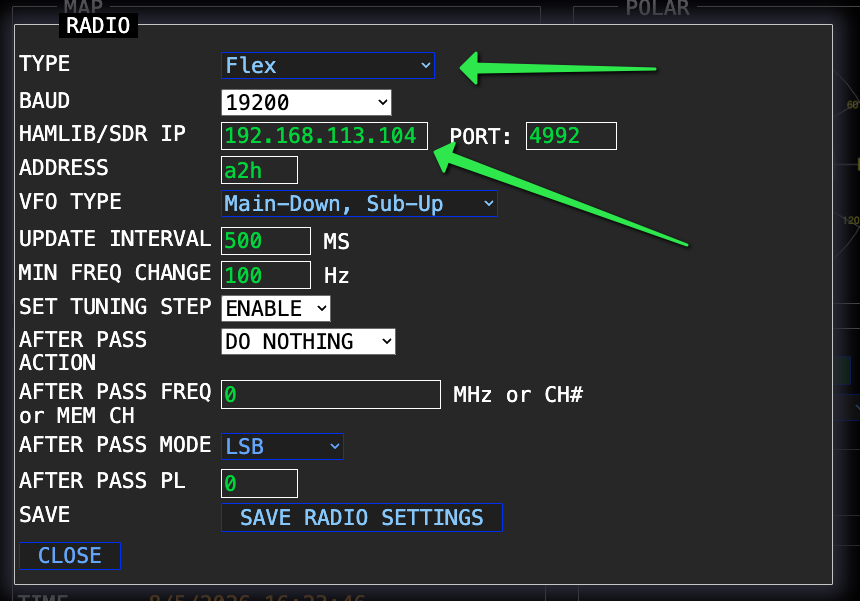

    How is it set up to work
    It is pretty simple. Select FLEX under radio and then you do need to provide the IP address of the radio. You can find this in the Radio Settings / Network tab and a few other places.
    Don't use this number as this is for my radio on my local network. Yours will be different.
    PORT must be 4992. Do not change that.
    Most of the other settings have little impact.

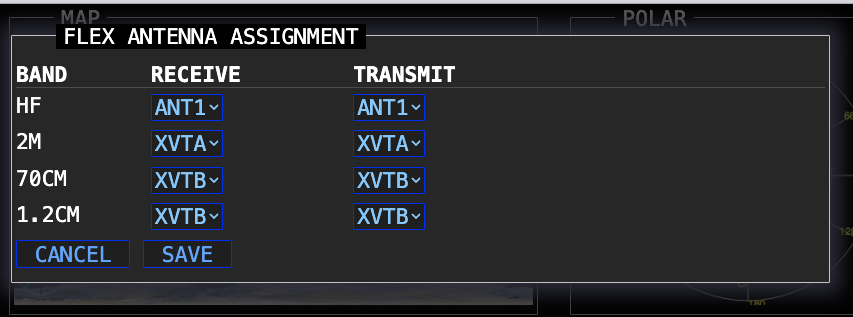

    On this screen, these have to match your installation.
