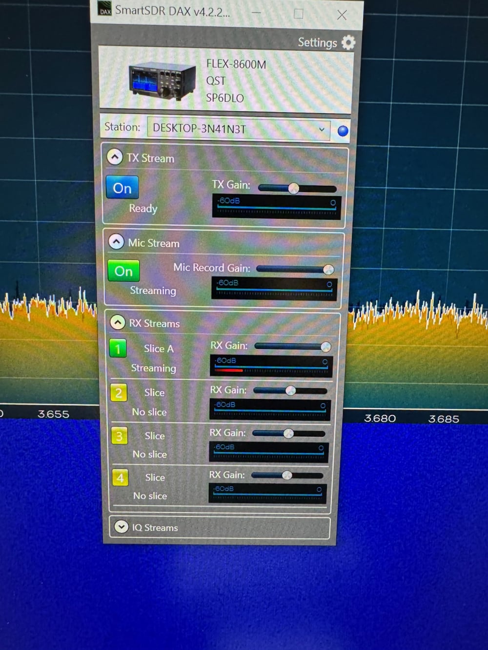

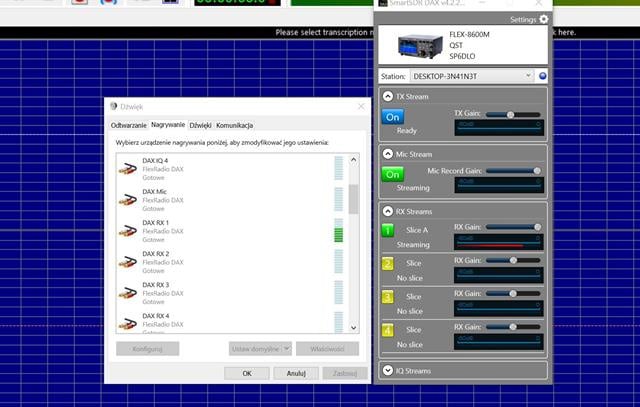

I can't set up DAX for recording with my audio recording software. In Win10, I select DAX RX1 in the audio settings. If the audio settings window in Win10 is open, I see a red band noise bar in DAX. If I close the WIN10 audio settings window, there's no audio signal from the band in DAX. I think SMART SDR+ DAX works differently.

What are you actually recording via DAX? There must be a client attached, a digital audio source. When you attach W10 audio settings you will see the DAX RX Stream Slice A color go green. Close W10 settings and it will turn blue. So you must actually have an audio source streaming on DAX RX1 and when you activate your recording software, it will record it.

Hi Eric, I want to record my audio signal from the second transceiver. I'm transmitting with a dummy load at 0.5W on the second transceiver. I turn on the Flex 8600 and see my signal on the same frequency. I can hear it clearly through my headphones. I want to record it using the DAX RX1 recording program. When I open "Sounds" in Win10, the RX stream lights up green and the audio bar is red. When I close it, the "1" icon lights up blue, but there's no red audio bar. That's where I'm having trouble configuring this.

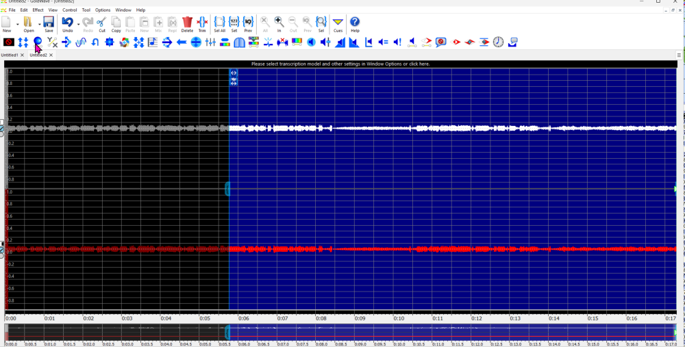

I just did it using Audacity. It is in the zip file. So it should work for you.

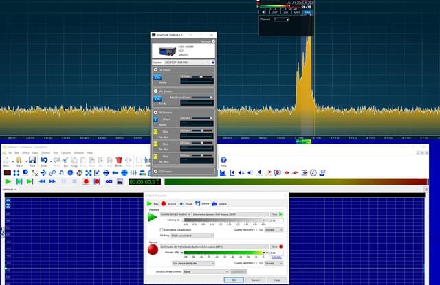

I believe you are using Gold Wave. I do not know why you have a problem. I just this minute downloaded and installed it. In Control properties I set DAX RX 1. All other settings were at default. It recorded perfectly.

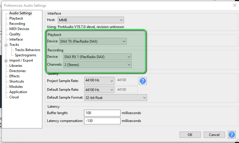

In Audacity, you do have to correct Audio Input and Output settings. Typically, this is what you want unless you want another source of audio. This setup would playback audio into the Radio TX chain and record from whatever slice you have assigned to DAX 1. I tested both 44100Hz and 48000Hz sample rates.

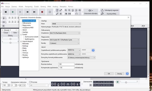

Thank you for your help. I have the audio set up in Audacity in Win10 as shown in the photo. Unfortunately, Audacity isn't recording because it doesn't have the audio from the Flex 8600. In Win10, when the record window is open, the audio level is controlled, as shown by the green vertical bar. When I close that window, the RX1 DAX disappears in the RX streams, with the audio level bar red. I'm not sure if this is correct. In Smart SDR, in the PROCESSOR window, I have DAX enabled in blue. In the upper window, below the frequency, DAX is set to Channel 1. Please advise what else I can do to record RX audio? I have WSJTX configured to work on FT8 using the same settings. Everything is working properly.

Mike-VA3MW Administrator, FlexRadio Employee, Community Manager, Super Elmer, Moderator adminOptionsIt looks like you have the wrong DAX RX 1 selected as that is the old DAX driver.
Look for "DAX RX 1"
