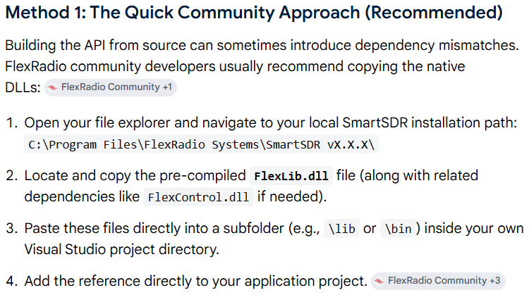

Can someone please tell me how to get a FlexLIB.dll file? Everything I can find seems to be out of date. This is typical of what I can find:
There are no .dll files in the install location. The file "FlexLIB.dll" is not found anywhere on my computer (W11 Pro). I have downloaded the API library. Other instructions say to use .sln or .csproj files to build the dll but I see no .sln files and one .csproj file in UiWpfFramework. Almost all the files seem to be .cs files.

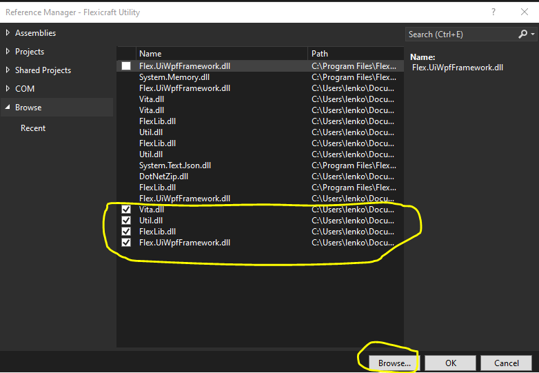

In my application, I add references to the four DLLs (note that the unchecked ones are from older builds)

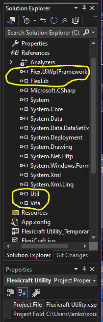

They then show in the Solution Explorer:
Now I can compile my app using FLexLib.
