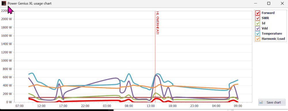

Check for any errors that you did not see at the failure by using the PGXL application, selecting the Usage Chart and examining the output. As an example:
You might see a recorded error - in the picture you see HL Overheat - yours might show HIGH SWR or something else (or maybe nothing at all).
