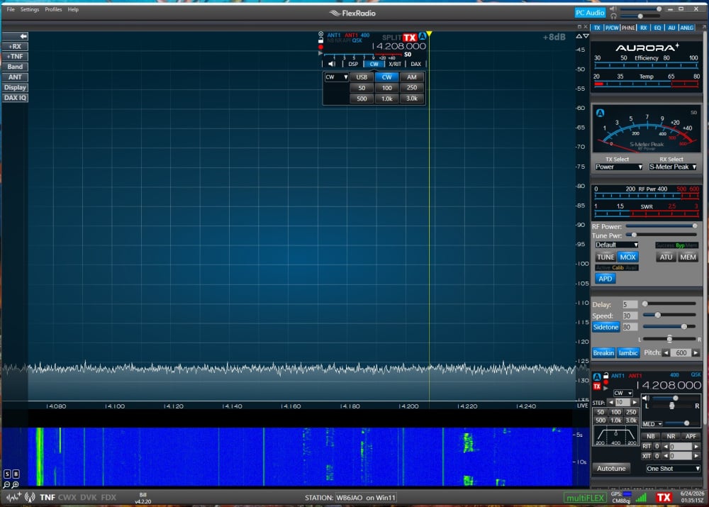

    SO, I put it on my personal website. The screenshot can be viewed at
    https://williamfinkelstein.com/images/AURORA_Screenshot_in_TX_with_zero_output_2026-06-23_183617.jpg
    I took the screenshot in CW Transmit mode. It shows zero output.

    Hi Bill, I could see the image. Were you keying the rig or did you click the MOX button? The MOX button in CW won't key the rig, you need to hit the key or paddles. Also, it looks like you are in multiFLEX mode, so your front panel might be what is getting keyed, not SmartSDR.
    Go to Settings, multiFlex… and make sure that Local PTT is set to SmartSDR. I only have one entry in the example below, but you will have two - one for the front panel and one for SmartSDR on your PC.

    Leonard, KD0RC - Controlling the slice isn't the issue. I'm doing that correctly. Note I did do some additional debugging using a tinySA and I do get some output when keying CW, but it doesn't show on the front panel PO gauge. Also nothing appears on the tinySA when I try SSB (yes, I'm saying "Test" etc.). Mic level is set mid point and the Waterfall display shows my voice, but no RF is apparent.
    I've been doing most of my debugging since I did the factory reset from the front panel of my Aurora 520M, I'll try Smartcontrol later today. I have been able to control the radio fine from either the front panel or SmartSDR+ fine.
