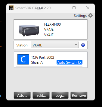

Whats happening is:
CAT becomes unresponsive, clicking the Icon for CAT does nothing. To make it become reactive. I have to start a reinstall of SmartSDR 4.2.20, Select Repair, reinstall 84fe.msi and reboot.
Also on the restart ALL of my added CAT settings are lost regardless of the fact they have been saved.
Looking at Device Manager all of my saved Cat Ports are there, BUT are not shown in the SmartSDR CAT popup.
Will be grateful if someone can point me in the right direction

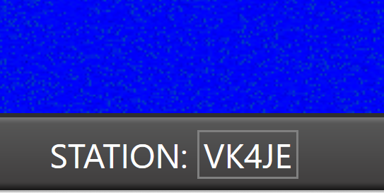

If you click on the “Station” pulldown next to your call do you see other choices? I’ve been using CAT with SmartSDR and Aether and I have two different choices (using Windows 11). Depending on which SDR program I’m using, it is one or the other choice to get the expected settings. The other choice is empty. Mark - wd9jen.
Hi Mark,
No, I only have the callsign and no additional 'Pull Down"
