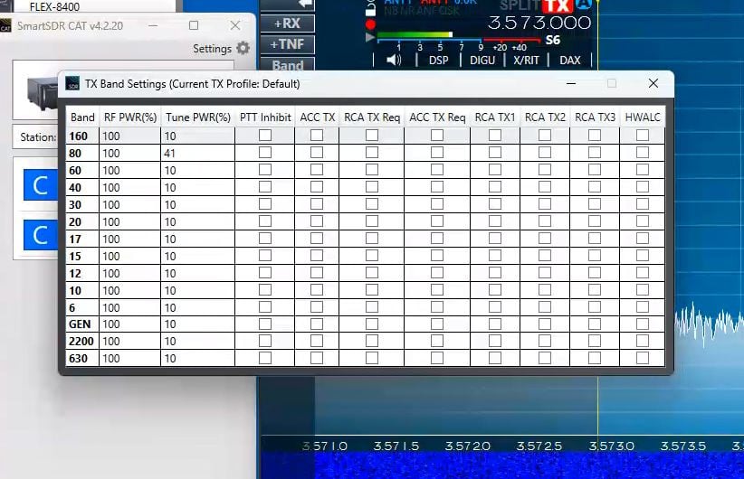

I'm connected to a dummy load (I've actually tried 2 different dummies). When I click on tune, the TUNE and MOX buttons light and the panadapter waterfall stops, but there is no indication on the TX meter, even if I slide the tune power up to 100%. This is consistent on all bands. I've performed a full reset (twice), but there is no change.
I plugged in the microphone, and the Level and Compression indicators dance in keeping with my voice, but there is no indication of power output in the TX window, even with the power slider at 100%. TX filters are set with Low Cut at 100 and High Cut at 3000. And yes, I am in band.
