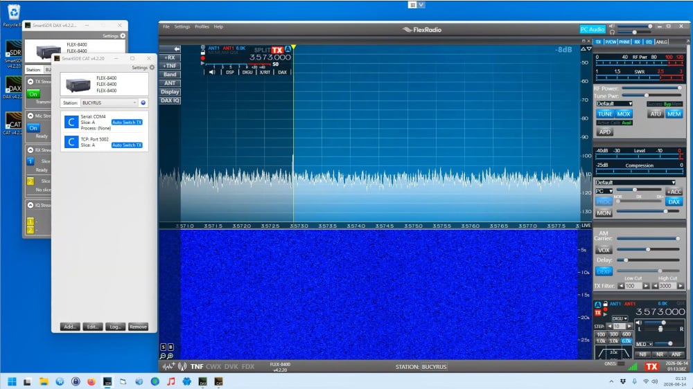

    Here's a screenshot while the TUNE is on but the RF is not indicating.
    Hi Mark, Can you check your TX Band Settings to be sure that PTT Inhibit is not checked for 80m meters?
  • Mark K0JM
    Mark K0JM Member ✭✭
    In the TX Band Settings there are no boxes checked of any kind on any band.
