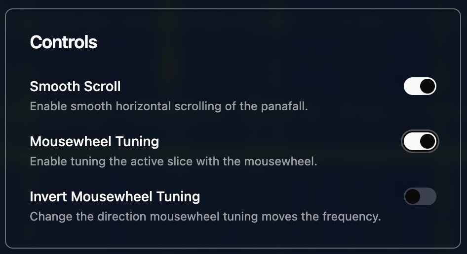

  • daveisadork
    daveisadork Member ✭✭
    So I tried SolidSDR for the first time from my Windows Chrome Desktop browser. Is the mouse-wheel scroll wheel not implemented for tuning?
    @K2KXK the latest release includes mouse wheel tuning. It's disabled by default, but you can enable it in the App Settings.
    You can download it here
    https://github.com/daveisadork/solid-sdr/releases/latest
