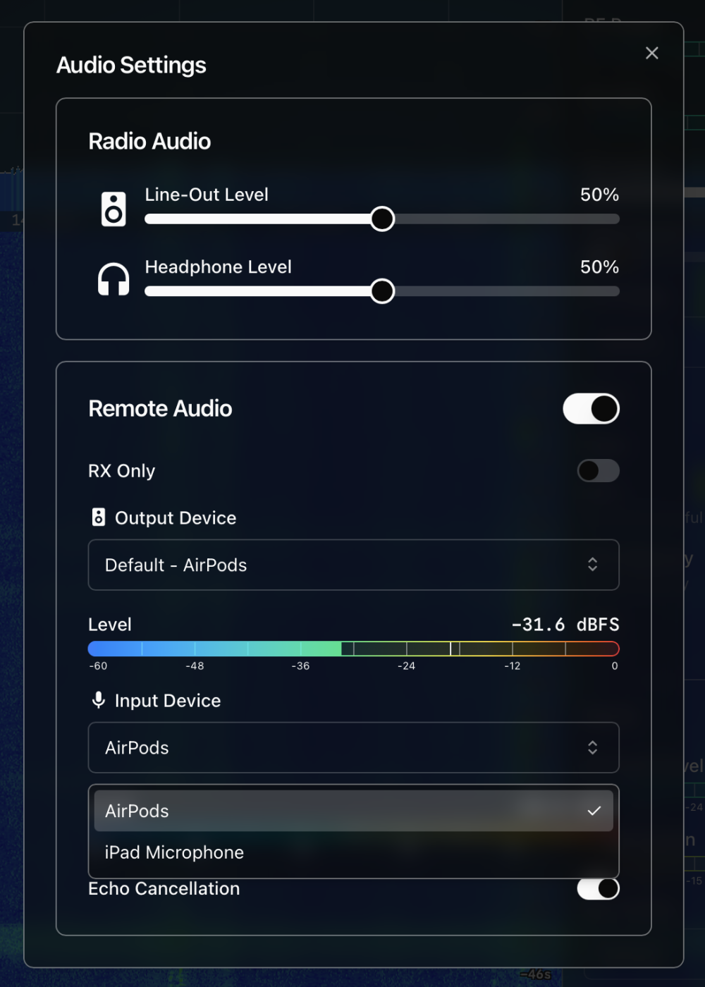

hi Dave. Thanks for the great browser based implementation. My main use case is to be able to access my flex from an android tablet using chrome. Was successful today on the receive side. I couldn't figure out what input source to set for my ssb mic. Chrome has mic permissions. Tried PC but no joy . Any idea? Something that would be useful for this use case would be a way to fine tune the frequency without a mouse . Thanks again and I'll be following the development closely
PC is correct. Make sure you have the correct device selected in the Audio Settings dialog. Touch the gear icon in the lower right corner and choose Audio Settings:
There is more information about troubleshooting TX audio in the wiki:

Hi Dave. Well, my problem seems to be that the app thinks chrome doesn't have audio permissions. When going to audio settings, it says audio permissions denied. Chrome has mic permissions but i don't see a setting other than that.
Apologies if you’ve already checked this. The only Android devices I have access to at the moment are old, so things might be a bit different. There are 2 different audio permissions… The OS level, where the OS allows Chrome to access the mic, and another where Chrome allows specific pages to access the mic. It sounds like the second one is what we’re missing.
It prompts you the first time you load the page but it’s easy to accidentally dismiss it, and Chrome will remember that forever. On my device there’s a little settings icon in the address bar, and tapping that shows Permissions with Microphone allowed. If it doesn’t say that, tap to change it. If that’s what you’re seeing too, then try a refresh or opening in a new tab and see if it picks it up.
If it still isn’t working can you share a screenshot of where you’re checking the Chrome mic permission?

AAny of those suggestions would be great. And you nailed it on the android chrome permissions. The mic was disabled for the site. Probably because it thinks itit doesn't have a valid cert. Thanks again. I'm having lots of fun with it. BTW, running the server on a pi 4. Runs great. No stuttering and the pa looks fine.
