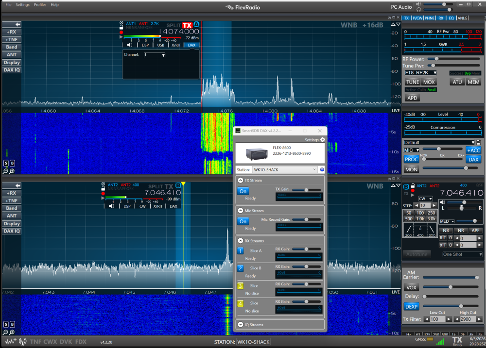

It looks like DAX is working. Do you have the correct DAX input/output selected in the program that uses DAX audio? The DAX audio streams changed names, so you need to reset them to the new values. For example, here is the audio setting for VARAHF:
In Windows Settings, you should see these input devices:
Notice that all the "Reserved" device names no longer appear. It is much easier now to find the device that you need.
Len,
Thank you. I am trying to set up the SliceMaster with the new 8600 and WSJT-X. SliceMaster puts out the message that "Audio Channel is not enabled in DAX control panel, DAX=1, Slice A."
WSJT works when I launch is separately rather than from the SliceMaster. I kind of assumed that if I do not see the Audio line moving in the RX streams of the SmartSDR DAX, then this is where the issue is. But interestingly, when WSJT is working and decoding, there is still no indications of the DAX audio in the SmartSDR DAC panel. How should it work? Should I see the audio lines moving there? If not, what is it for?

It looks like this is the SliceMaster issue that is not aware of the new DAX drivers.
Alex
Hi Alex, I don't think that SliceMaster works with 4.2.
