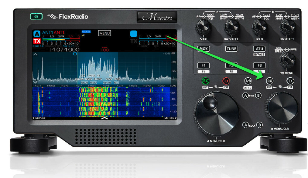

It has always been like this. The Maestro can only have 2 slices, so to **** one, press the Green RX button on the Maestro button to **** it.

You close the 2nd slice by pressing the Green RX button above the small VFO knob. This button creates and destroys the slide. There is no X to press on the screen.

Mark: Thanks for your response. That button appears to me to activate and deactivate the slice. It does not appear to actually remove the slice, which still much be hidden, if you don't want to deal with it at that time. Maybe that's splitting hairs, but activation and removing appear to me to be two different concepts. On my computer, it appears that I can actually remove slices that I don't want at the moment. Am I missing something here? — 73 de Carl N8VZ

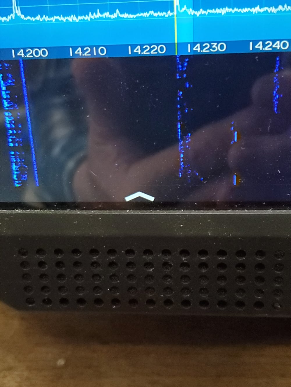

Touching the up arrow button adds a panadapter. Touching the down arrow removes it. If you simply want a Slice receiver on the same panadapter ( working split or just listening to two different conversations on the same band) then doing like Mike pointed out will work.

Yes, it does remove the slice as there is no reason to have a hidden slice since there would be no way to control the VFO, etc.
