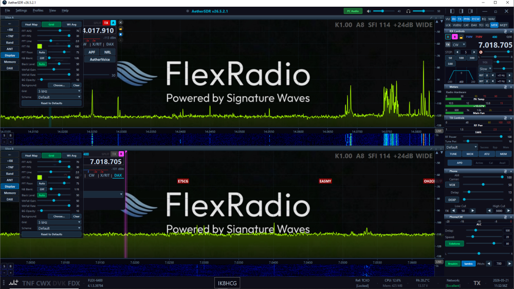

I downgraded to 4.1.5 and everything works again with sdrBridge and slicemaster, especially AetherSDR.
