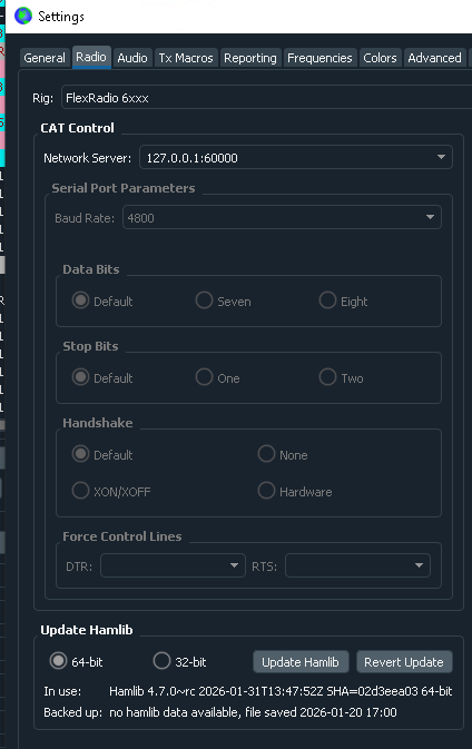

    • How are you doing CAT control win WSJT as there are 3 or 4 ways to configure this. Is it RS232, Hamlib or TCP/IP?

    Mike, I tried setting up WSJT/JTDX using the Flex6XXX for the RIG and localhost:60000 for the CAT TCP port and the failure is exactly the same as described above.
    If you don't use the DX Commander part and use a direction connection to CAT does the problem go away?

    It does not matter which RIG connection method I use, results are the same .
