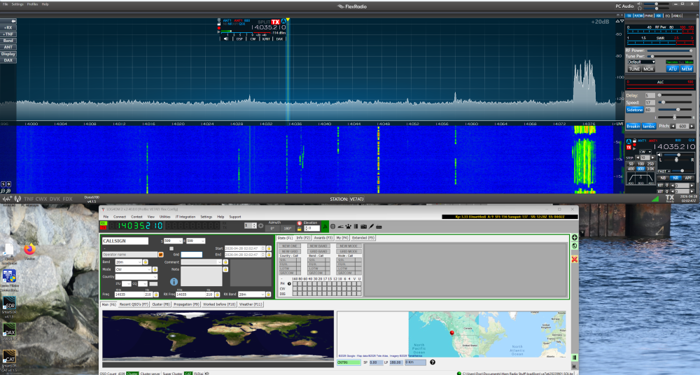

I can tell you that I run two (2) 4k monitors attached to my Windows 11 PC and I can run SmartSDR on either one of them very successfully. It's great having the expanded band span of a wide monitor (both are approx 27in models). I even suppose that with proper configuration of the displays, I could have SmartSDR running across both monitors combined! :-)
Anyway, I keep it to one for now with Log4OM running below it, while the other runs web-browser look ups, like QRZ.com, POTA, SOTA, etc.

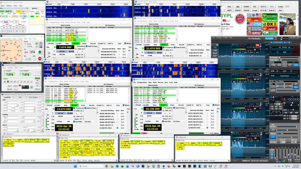

Your new TV will need to support 4:4:4 Chroma in order to display text cleanly, which it presumbly does in PC Mode. I have a 43" TCL 4K (43Q65) with Google TV (just $220) that works very well; shown below running four instances of WSJTX, four instances of JTAlert, DX Lab apps, SmartSDR with four panadpaters, DDUtil and PstRotatorAz. Several other apps are minimized.
My desktop lacks horizontal space for multiple displays, so a single 43" 4K TCL TV is a good solution and it is a fraction of the cost of a dedicated 4K computer monitor in the same size. My eyes are positioned about 24" from the display at mid-level without strain or grainy images. Newer 4K TVs are by default very bright, so you will likely want to reduce brighness substantially when using as a PC monitor. I have my TCL set to just 30% of max brightness.
