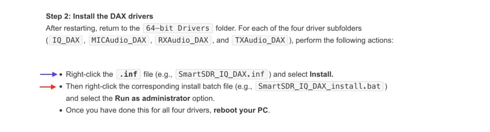

    Okay, I've found the solution 😍
    I forgot to do the blue arrow thing.
    I only did the red arrow thing.S orry for the fuss...
    My bad 😱
