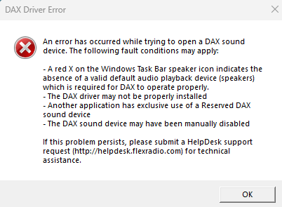

When I start DAX, I get the following error message.
I can't find the cause. The help desk couldn't answer it either...

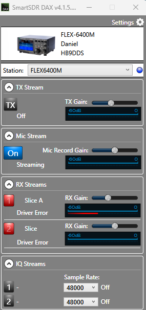

  • David Decoons, wo2x
    usually that happens when the computer tries to grab one of the DAX drivers as a default record or playback device.
    Try setting the TS480 as default record device and the high definition audio device as default playback device. or if you have a USB PC mic, plug that in and set to default record device.
    Reboot then follow this procedure to reinstall DAX drivers.
    https://helpdesk.flexradio.com/hc/en-us/articles/41413843097883-How-to-Manually-Reinstall-the-DAX-Drivers
    73 Dave wo2x
    This is a fixable problem. If you open a support ticket they should be able to sort you out.

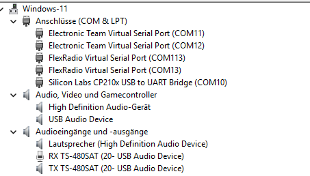

    I've done this so many times. Also this afternoon (again). No success
    Oh yes, I opened a ticket on October 28, 2025. But they had no solution and gave up...
    I reinstalled SmartSDR on a new Windows 11 partition. It works perfectly there.But what's causing the problem?
