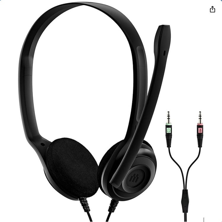

I have a 6400M and a Sennheiser PC3 headset.
I use it with all my transceivers (not the Flex). An adapter supplies the headset with 8V.
The 6400M has a separate microphone input. The original FHM-2 microphone has a 3-pin connector.
In the menu, I can enable the bias. I thought this would supply voltage to the microphone jack, allowing me to use a headset with an electret capsule. But it doesn't work.
Am I misunderstanding something?
Daniel
HB9DDS

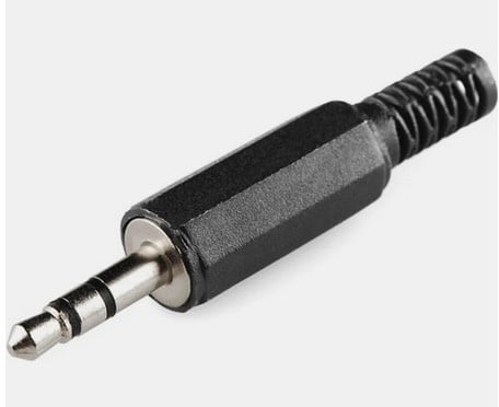

Check the headset and see if the MIC connections are TIP and Sleeve or Ring and Sleeve. It makes a difference.

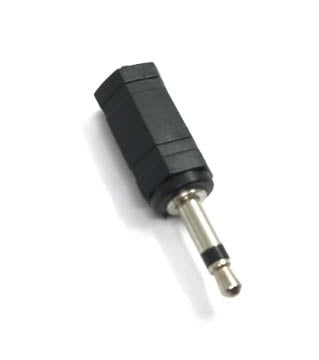

My Koss SB400 will NOT work on my 6600M without an adapter that I bought on Amazon. I’m not at home, but I think it was a Mono to Stereo adapter that removed the Ring from the circuit.
A Stereo to Mono Adapter was the solution.
