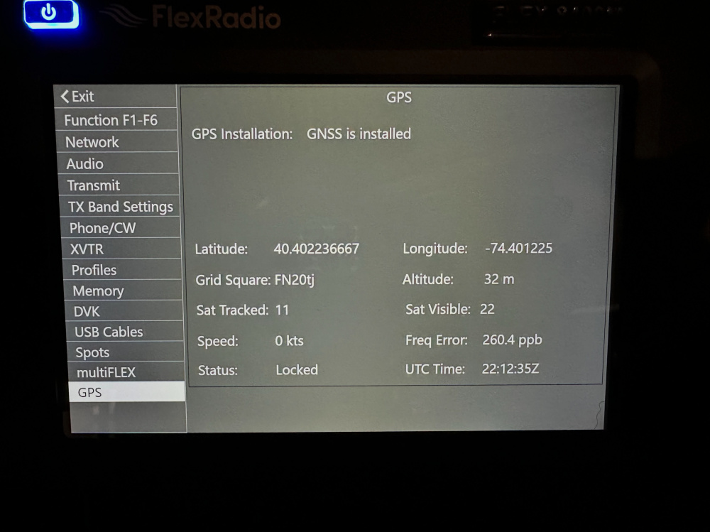

Mike-VA3MW Administrator, FlexRadio Employee, Community Manager, Super Elmer, Moderator adminOptionsIs this on the radio GNSS for the radio or the GPSDO?
Can you post a screen short of your satellite report?
Greetings Mike-VA3MW,
GNSS on a 8400M running SSDR v.4.1.5.
Photo below shown about 10 minutes or less after turning the radio on from a cold start.0
