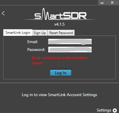

With Smartsdr 4.1.5 I can no longer log in with Smartlink.
Here in Europe, dual stack IPv4/IPv6 is now common.
The SmartLink login tries to call cdn.auth0.com, this is done via IPv6, because an IPv4 and an IPv6 address are returned and then it does not continue.
If I turn off IPv6 it works again.
Either you now finally introduce IPv6 or you take out the close resolution AAAA cdn.auth0.com.
