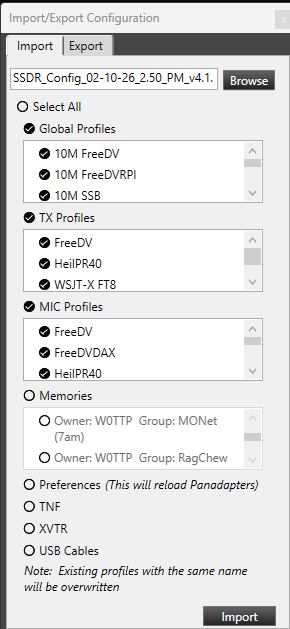

    1. Exported all radio settings before making changes.
    2. Performed a full factory reset, following the steps documented by Tim Ellison in the “How to completely reset an Aurora/Flex‑8000/6000” guide.
    3. Imported only “Custom” profiles, specifically:
      • Global Profiles
      • TX Profiles
      • Mic Profiles
        I did not import any built‑in/default profiles.
    4. Did not import Memories, since those can be reviewed easily via the Excel‑format export.
    5. Did not import:
      • Preferences
      • TNFs
      • XVTR settings
      • USB Cable configurations
    6. Identified two Global Profiles that consistently caused either radio reboots or SmartSDR display issues.
    7. Deleted those two profiles, then recreated them manually based on working profile copies.
    8. After these steps, the radio has been stable with no further issues.
