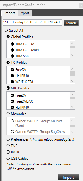

    Resolved Issue: FlexRadio 8600 Rebooting and SmartSDR Blank Panadapter
    After carefully monitoring when the radio rebooted and completing the full factory‑reset process typically recommended to resolve this behavior, I identified that the root cause was related to a small number of corrupted profiles. I wanted to avoid rebuilding all of my Mic, TX, and Global profiles from scratch, so I continued troubleshooting until I discovered a consistent pattern.
    Ultimately, I found that two Global Profiles were repeatedly triggering either:
    • A full reboot of the FlexRadio 8600, or
    • A blank panadapter (PAN) display within SmartSDR.
    Deleting only those two problematic profiles and recreating them resolved the issue completely.
    Detailed Procedure
    1. Exported all radio settings before making changes.
    2. Performed a full factory reset, following the steps documented by Tim Ellison in the “How to completely reset an Aurora/Flex‑8000/6000” guide.
    3. Imported only “Custom” profiles, specifically: "Make sure to uncheck any built-in Radio Profiles that show in the import list."
      • Global Profiles
      • TX Profiles
      • Mic ProfilesI did not import any built‑in/default profiles.
    4. Did not import Memories, since those can be reviewed easily via the Excel‑format export.
    5. Did not import:
      • Preferences
      • TNFs
      • XVTR settings
      • USB Cable configurations
    6. Identified two Global Profiles that consistently caused either radio reboots or SmartSDR display issues.
    7. Deleted those two profiles, then recreated them manually based on working profile copies.
    8. After these steps, the radio has been stable with no further issues.
